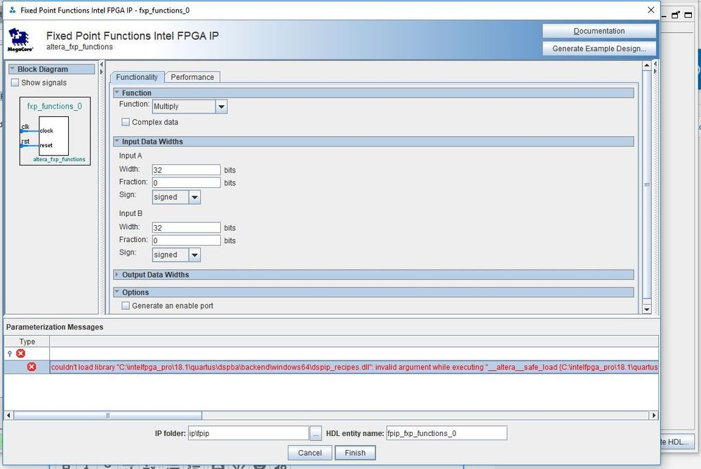

We migrated from 18.0 to 18.1 and one of the Multiply IP blocks fails to upgrade automatically. When we try and manually upgrade we get the message that dspip_recipes.dll is missing and in fact bvetween 18.0 and 18.1 the file is now gone. What do we do? Can we copy the .dll over?

Quartus Prime Version 18.1.0 Build 222 9/21/2018 SJ Pro Edition. No patches installed. I don’t think I can share the project, but the device is the following: set_global_assignment -name DEVICE 1SG280HU2F50E2VGS1 We are using the Fixed Point Functions Intel FPGA IP and instantiating a 32 x 32 multipier. We have the same issue on two machines that separately downloaded the installation from the Intel website. Both run Windows 10 Pro. Thank you, --Will - AnandRaj_S_Intel

We acknowledge this issue. I am confirmed that this bug was fixed in our internal release. Currently waiting for the next updates for next target release schedule.

Just to let you know the fix is finalized for both DSPIP_RECIPES.DLL (Window) and DSPIP_RECIPES.SO (Linux). The target release date for next Quartus version will be tentative around end of this year or early next years.
Please take note and this issue should be considered as closed at this point. Kindly continue to use this forums by opening up another new thread for more supports.
