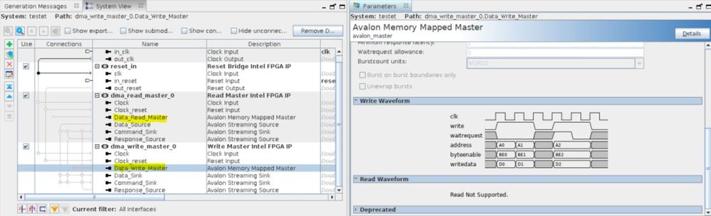

In the Platform Designer, you can click on the Data_Write_Master and the it will shows an example of a waveform.
Click the details on the top right corner to learn more.
