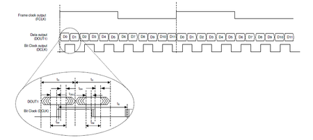

Hello, I am looking for guidance or an example design that explains configuring the ALTLVDS RX megafunction for use with a TI 14 bit LVDS ADC. The ADC has 16 LVDS channels, 1 bit clock (DDR) and 1 f...
