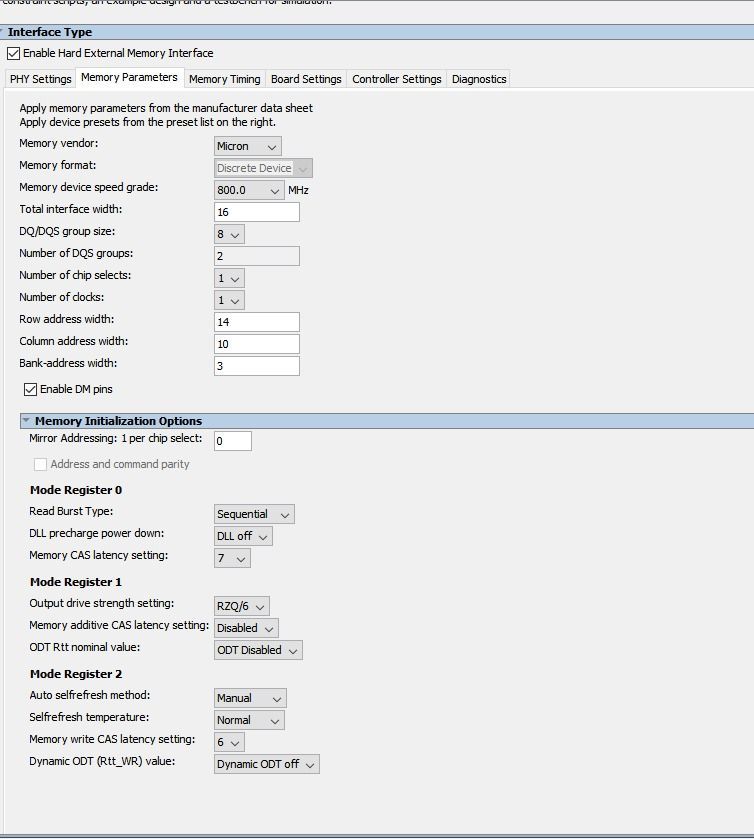

1) Please make sure the memory timing is fully comply with memory datasheet. Please note on the following dependent setting (picture is taken from other Quartus version). As you can see there are setting that depend on the frequency and temperature as well, thus it is important to make sure DDR3 settings and timing parameters in the GUI match the device specs in datasheet.
