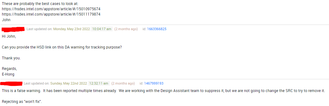

  • Hi,
    Below are the messages from internal:
    This is a false warning. It has been reported multiple times already. We are working with the Design Assistant team to suppress it, but we are not going to change the SRC to try to remove it.
    I am working with the Design Assistant team to provide a way to disable this error in the SRC RTL. Right now, this cannot be done.
    Check the attached picture. Can just ignore them for now.
    Sheng
    Sheng
