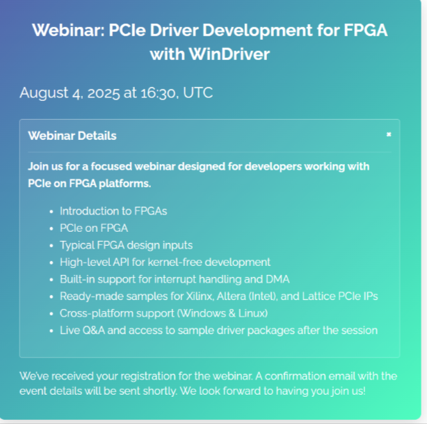

    Also there is a coming webinar where would be helpful to you.

    Hi Wincent,
    Thank you, this is very helpful and great timing. I'll look a bit further...
