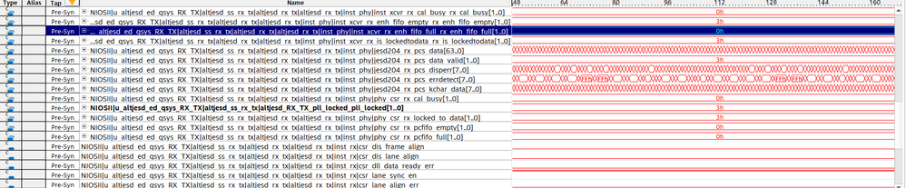

With same AD9082 EVM ,I have tested on Both by changing reset delays in transceiver reset controller. Still getting errors.
Please help us to resolve this issue. I need to bringup jesd .Please find logs of test result.
