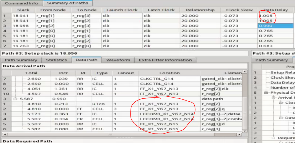

However, when I tried to compile using Quartus II had a very strange "FMAX" results.
  1. Listing 9.3 – Area: 5 LE. FMAX: 761.04 MHz
  2. Listing 9.4 – Area: 5 LE. FMAX: 171.7 MHz
Why is FMAX so different? I couldn't explain it.

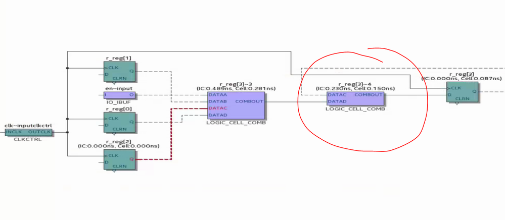

    Listing 9.3: Referring to Line 30, gated_clk <= clk and en; , en is added to control the gated_clk. The data delay from r_reg[*] to r_reg[*] is smaller compared to Listing 9.4
    Listing 9.4: Referring to Line 54: r_next <= r_reg + 1 when en='1' else , en is added to control the register. The data delay from r_reg[*] to r_reg[*] is larger due to the additional combi logic between the register. This is why Listing 9.3 has better Fmax.
