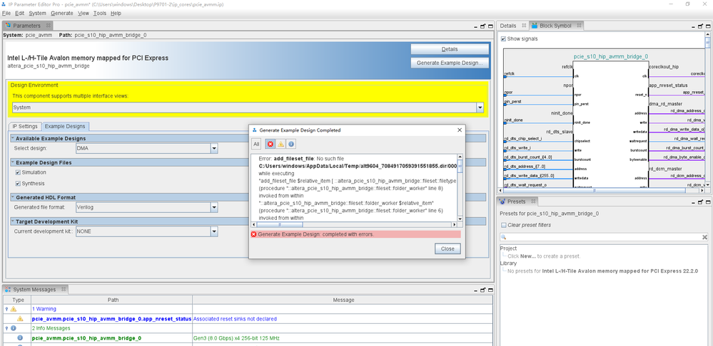

Can you please provide me the device OPN ? I will try to replicate this on my place and see if I can see the same error as yours or not.
Wincent_Intel
- Wincent_Altera
Can I know which version of quartus you are using ?
Normally this error happen when
When you clean project, the folder of IP in your case XXX.ip is being deleted.
Therefore, you have to re-generate HDL of XXX.ip before you can generate HDL of your qsys system.
Then add_fileset_file "file not found" error should be resolved.
