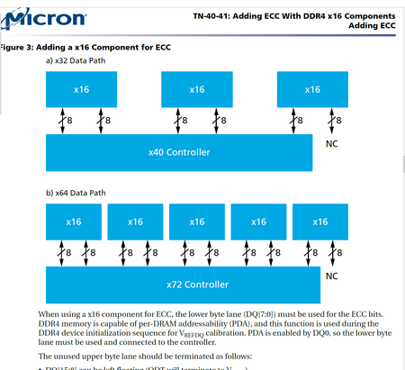

11 months agoWhy 10AS016C4U19E3SG could use the x16 DDR4 component upper byte lane[DQ8~DQ15] for ECC?
Hi team, there are three x16 DDR4 components 【MT40A512M16LY-075:E】 in my board, The upper 8 bits of the lastcomponents are used for ECC. but I learn about a rule from Micron applicatio...

Yes, Upper byte lane (DQ[15:8]) could be used for the ECC bits

could you please tell me why Arria10 can support ? Micron said PDA is only enabled by DQ0 , thank you very much!
