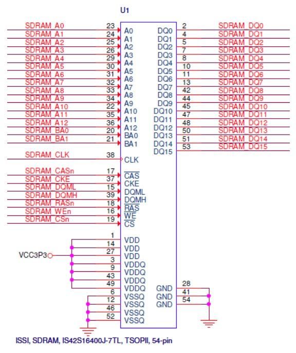

My dev. board has a SDRAM part: ISSI, IS42S16400J. I have an older project (for Quartus 15) with the SRAM IP core that worked but when I opened it in Quartus Lite 21 the upgrade window said that it couldn't find the ip core for the SDRAM controller. I found a link to an enhanced SDRAM controller but the help page says it is for Quartus 17. Is the SDRAM IP core available for Quartus Lite 21? If not, what version of Quartus Lite do I need? I don't mind downgrading if necessary. Here is the schematic of my dev. kit showing the SDRAM. Thanks
