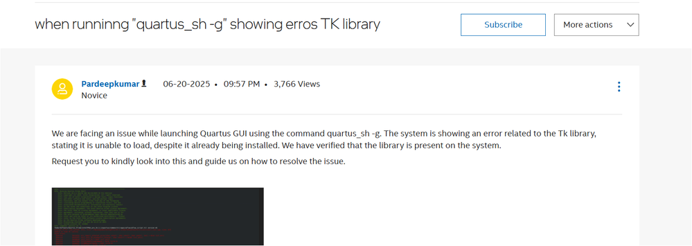

when runninng "quartus_sh -g" showing erros
Hi Team,
We have already informed you that we prepared a laptop with RHEL 9; however, we are still encountering the same issue.
[root@5CD35048B0 ~]# quartus_sh -g
Info: *******************************************************************
Info: Running Quartus Prime Shell
Info: Version 24.3.0 Build 212 11/18/2024 SC Pro Edition
Info: Copyright (C) 2024 Intel Corporation. All rights reserved.
Info: Your use of Intel Corporation's design tools, logic functions
Info: and other software and tools, and any partner logic
Info: functions, and any output files from any of the foregoing
Info: (including device programming or simulation files), and any
Info: associated documentation or information are expressly subject
Info: to the terms and conditions of the Intel Program License
Info: Subscription Agreement, the Intel Quartus Prime License Agreement,
Info: the Intel FPGA IP License Agreement, or other applicable license
Info: agreement, including, without limitation, that your use is for
Info: the sole purpose of programming logic devices manufactured by
Info: Intel and sold by Intel or its authorized distributors. Please
Info: refer to the Intel FPGA Software License Subscription Agreements
Info: on the Quartus Prime software download page.
Info: Processing started: Fri Jul 18 18:45:37 2025
Info: System process ID: 5290
Info: Command: quartus_sh -g
/home/Software/Quartus-pro-24.3.0.212/quartus/common/tcl/apps/qflow/qflow_script.tcl version #1
Internal Error: Sub-system: ATCL, File: /tmp/psgswbuild/nightly/24.3/212/l64/p4/qcore/ccl/atcl/atcl_root.cpp, Line: 673
Unable to load Tk library
Stack Trace:
Quartus 0x11415: err_report_internal_error(char const*, char const*, char const*, int) + 0x1a (ccl_err)
Quartus 0x24417: atcl_init_tk_window(Tcl_Interp*, char const*) + 0x10c (ccl_atcl)
Quartus 0x4cbb8: atcl_init_tk + 0x87 (ccl_atcl)
Quartus 0x4753b: TclInvokeStringCommand + 0x7b (tcl8.6)
Quartus 0x4bb47: TclNRRunCallbacks + 0x67 (tcl8.6)
Quartus 0x4cf29: TclEvalEx + 0x599 (tcl8.6)
Quartus 0xf40fe: Tcl_FSEvalFileEx + 0x21e (tcl8.6)
Quartus 0xf4246: Tcl_EvalFile + 0x26 (tcl8.6)
Quartus 0x285c0: qexe_evaluate_tcl_script(std::__cxx11::basic_string<char, std::char_traits<char>, std::allocator<char> > const&) + 0x3b8 (comp_qexe)
Quartus 0x2b7aa: qexe_do_tcl(QEXE_FRAMEWORK*, std::__cxx11::basic_string<char, std::char_traits<char>, std::allocator<char> > const&, std::__cxx11::basic_string<char, std::char_traits<char>, std::allocator<char> > const&, std::__cxx11::list<std::__cxx11::basic_string<char, std::char_traits<char>, std::allocator<char> >, std::allocator<std::__cxx11::basic_string<char, std::char_traits<char>, std::allocator<char> > > > const&, bool, bool) + 0x7c3 (comp_qexe)
Quartus 0x317d7: qexe_standard_main(QEXE_FRAMEWORK*, QEXE_OPTION_DEFINITION const**, int, char const**) + 0x5b2 (comp_qexe)
Quartus 0x404191: qsh_main(int, char const**) + 0x6f (quartus_sh)
Quartus 0x44888: msg_main_thread(void*) + 0x10 (ccl_msg)
Quartus 0x452f8: msg_thread_wrapper(void* ()(void), void*) + 0x8c (ccl_msg)
Quartus 0x2118d: mem_thread_wrapper(void* ()(void), void*) + 0x9d (ccl_mem)
Quartus 0xe2d8: err_thread_wrapper(void* ()(void), void*) + 0x1e (ccl_err)
Quartus 0x4520d: msg_exe_main(int, char const**, int (*)(int, char const**)) + 0xd3 (ccl_msg)
Quartus 0x4041d3: main + 0x26 (quartus_sh)
System 0x295d0: __libc_start_call_main + 0x80 (c)
System 0x29680: __libc_start_main + 0x80 (c)
Quartus 0x403cda: _start + 0x2c (quartus_sh)
