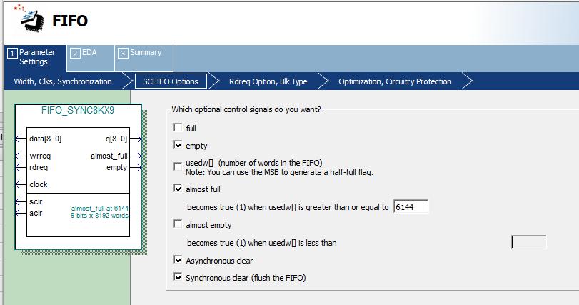

What is the difference between these two clear signals?
Hi, I’m currently investigating an issue. I’m using an FPGA SCFIFO to replace a 72V251 FIFO, with rclk = wclk.
I found that if I keep rebooting the device, my industrial camera occasionally shows image tearing. However, this does not happen every time, and my pixel clock is only 36 MHz, so I would not consider it a very high frequency.
Could I ask what the difference is between these two FIFO reset options?
  • Asynchronous clear
  • Synchronous clear (flush the FIFO)
  • All documented:
    https://docs.altera.com/r/docs/683522/25.1.1/fifo-ip-user-guide/fifo-synchronous-clear-and-asynchronous-clear-effect

  • Thanks, sstrell, for sharing the documentation link.
    Hi MartinMaa,
    Regarding the image tearing issue, I noticed that you had previously filed a support ticket for a similar problem. May I check is issue has been resolved?
    For the differences between synchronous clear and asynchronous clear, you may refer to the documentation link shared by sstrell, at Section 1.7 FIFO Synchronous Clear and Asynchronous Clear Effect.
