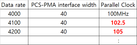

3 years agoWhat is the "Desired Reference clock frequency"? (fpll)
Hi- Everybody
I tested a chip.
Test is data in put and then other chip any signal output.
It was successful up to 4G.
In higher frequency than 4G failed.
But in fPLL GUI, wrote the some va...

Desired Reference clock frequency is a valid values for reference clock frequency and it change with the data rate but the reference input clock frequency must be within 50 MHz and 622 MHz. Range of supported reference clock frequency is dependent on device. You may device datasheet for range of supported frequency for every device.
