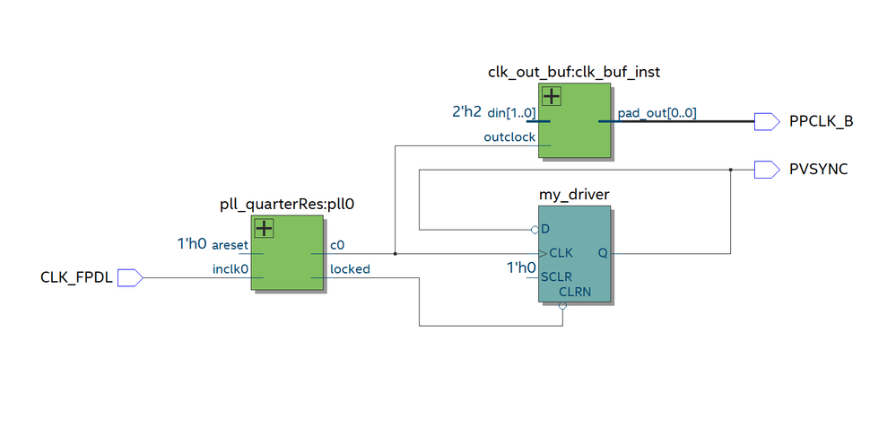

I came across a strange problem. Bringing it to its simpliest version I got the situation as show below.
Detailed implementation:
The device is 10M08SAU169I7G (Quartus17.1 Lite). Alongside with logic I have output timing constraints as follows:

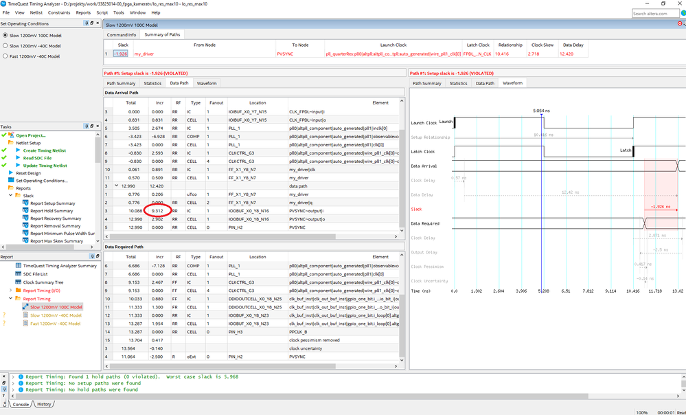

Timing is not met (results below).
The question is why is the interconnect delay so high? How to deal with it?
The curious thing is, when I change output delay constraints clock to c0, the same interconnect is nearly 0.

  • The design has such a high interconnect delay is due to the huge clock skew. In order to meet hold time requirement, the router will need to add additional routing delays.
    Why huge clock skew you might ask? That's because this is a cross-clock transfer.

      Hello skyjuice,
      Thanks for putting me on the right tracks. Although I don't know about cross-clock transfer (could you possibly point me to some literature?). What I understand from your response is clock skew is so high, partially, due to use of DDIO buffer (which introduce additional delay to the required path). Removing it and modifying output delays to be referenced to FPGA pin solved the problem.
