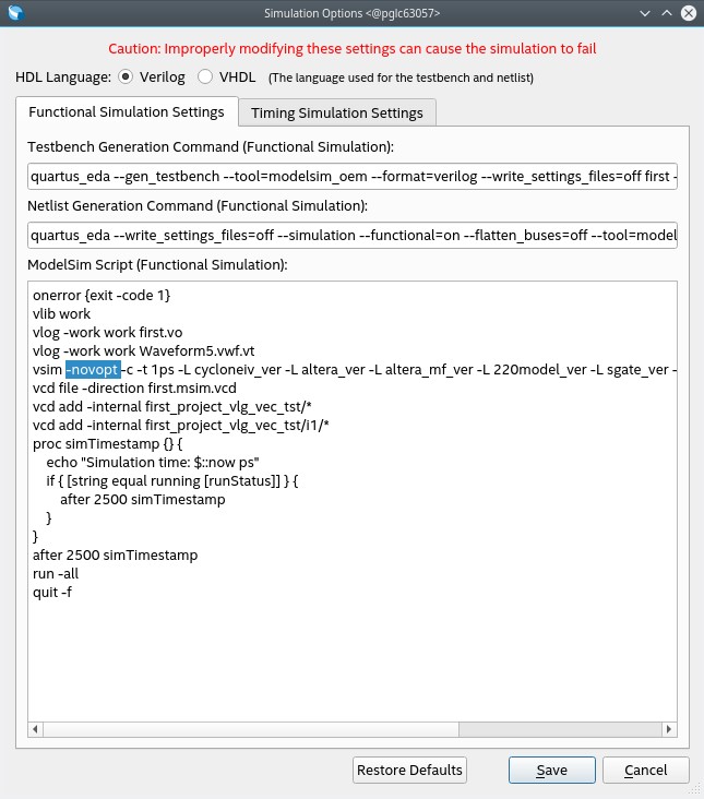

    Attached with the screenshot of VWF Simulation Settings to remove "-novopt".
  • VenT_Altera's avatar
    VenT_Altera
    For error shown as in image 1, after open VWF, in the Simulation Waveform Editor window, go to Simulation > Simulation Settings. Remove the "-novopt" for both Functional and Timing Simulation Settings > Save. This will solve the error.
