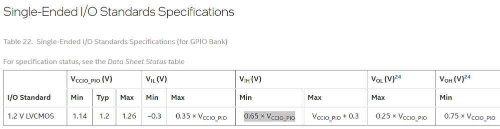

VCCIO_PIO on the agilex7 datasheet
Hello
about Single-Ended I/O Standards Specifications on Agilex 7 :
it mentioned on datasheet that VIN_H = 0.65 × VCCIO_PIO
https://www.intel.com/content/www/us/en/docs/programmable/683301/current/single-ended-i-o-standards-specifications.html
My question is about the VCCIO_PIO value : what's its value ?
I am working on 3rd part board . should I ask the vendor ? or its a value that i can set /view from Quartus prime tool ?
Thx
Kikoss
  • Hello,
    Sorry for the delay. For your information the value of the VCCIO_PIO as stated in the table from the datasheet is 1.2V for I/O standard 1.2V LVCMOS.
