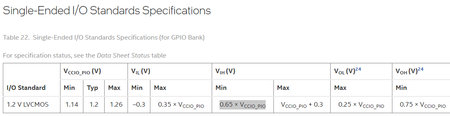

VCCIO_PIO on the agilex7 datasheet
- 2 years ago
Sorry for the delay. For your information the value of the VCCIO_PIO as stated in the table from the datasheet is 1.2V for I/O standard 1.2V LVCMOS.
Hope that answers your question and do let me know if I can assist you further.
