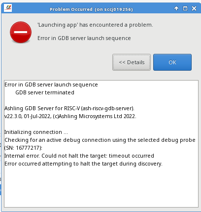

4 years agoUsing RiscFree for Nios V Development: Error occurred attempting to halt the target during discovery
I am trying to run a Hello world program on the Nios V processor using an Agilex I-Series Transceiver SOC Dev Kit. The example that I'm trying to generate is found here in the Nios V Handbook, under ...
allenS1
4 years agoHi Teh,
Sorry for not updating you sooner, but this issue has been solved. I think the issue was with the IPs in the system I used needing to be upgraded. Once I performed an IP upgrade on the necessary components and recompiled, everything was able to work fine with no errors. I had already changed the device, device family, and clock pin assignments before posting this issue. Thank you for responding though.
