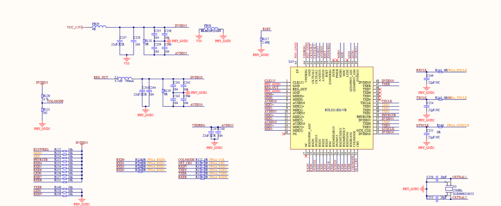

I am currently facing a problem where I read two PHY IDs on one PHY, which caused my chip's self negotiation to fail
why? why?why?

WARNING : Unknown PHY found at PHY address 0x00 of MAC Group[0]
WARNING : Please add PHY information to PHY profile
INFO : PHY OUI = 0x000732
INFO : PHY Model Number = 0x11
INFO : PHY Revision Number = 0x5
INFO : PHY[0.0] - Explicitly mapped to tse_mac_device[0]

WARNING : Unknown PHY found at PHY address 0x01 of MAC Group[0]
WARNING : PHY[0.X] - Mapping of PHY to MAC failed! Make sure the PHY address is defined correctly in tse_mac_device[] structure, and number of PHYs connected is equivalent to number of channel
WARNING : MAC Group[0] - Number of PHY connected is not equal to the number of channel, Number of PHY : 2, Channel : 1

  • Hello zhangxianyu,
    Is it connected to an external PHY?
    Pavee
    • zhangxianyu's avatar
      zhangxianyu
      您好,我的板上只有一个 phy
        zhangxianyu
        Hello, there is only one phy on my board
