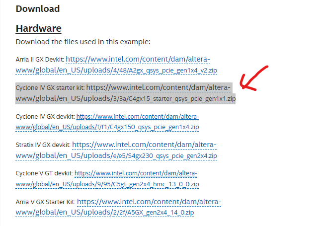

- Wincent_Altera
Cyclone IV are available as shown in below
Hope this is helpful,
Wincent_Intel

- Wincent_Altera
Hi Miguel,
Cyclone IV are available as shown in below, just scroll down abit
https://community.intel.com/t5/FPGA-Wiki/PCI-Express-in-Qsys-Example-Designs/ta-p/735762
Wincent_Intel
