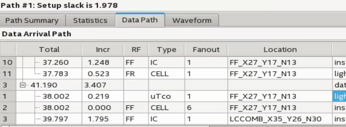

    You may use report_timing to check the datapath and clockpath
    Example of the report:

    Thanks for your reply, so , how can I check the timing calculated for the "clock to ouput times". I would like to check the datapath & clockpath.
    Thanks!

    You may generate the Clock to Output Times by clicking on Timing Analyzer: Reports > Datasheet > Report Datasheet
