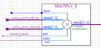

I am using a large number of Quartus IP LPMMULT "Basic Functions" both in parallel and then in series to calculate a 32 bit number from a large number of 16 bit (unsigned) array of numbers.
Its a large branched tree. I assume each multiplication takes place with a low to high clock pulse. How do I know when the calculation is done to issue a clock pulse to the next adder using a pair of result[31..0] values from the previous multiplier.

lpm_mult has a configurable latency (e.g. one clock cycle) it's set in Megawizard.
Don't know how you arrive at 32 bit output for 8x8 multiply?
lpm_mult IP supports up to 256×256 multiply in so far there's no need in cascading multiplier blocks manually.
- John-Monahan
I have a large number of 8 bit paired inputs which I later all add together. Essentially a large matrix dot product.
