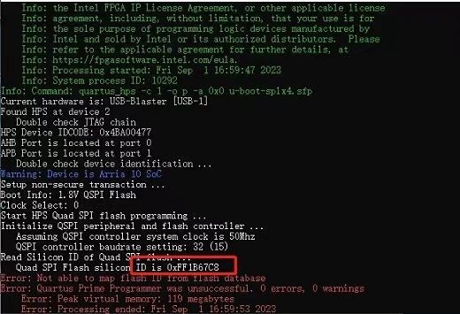

Question: GigaDevice NorFlash, model GD55LB01GEFIRY, cannot be burned through Quartus command line or graphical interface tool. In the following figure, the red box indicates an error when writing on the command line. The ID cannot be identified.
Requirement: You can write NorFlash GD55LB01GEFIRY mounted on the HPS using the command line interface (CLI) or GUI. The command line is preferred.

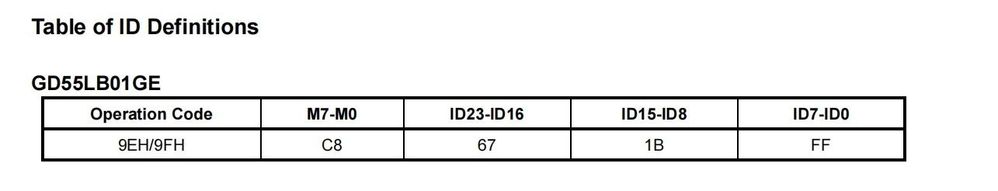

Data: The following figure shows the ID marked on the Flash manual of the model.

Sorry to inform you that the flash that you are using is not part of the supported devices in the list
That is the reason of the error message you are looking at.
Jingyang, Teh

The quartus programmer only supports QSPI and NAND Flash.
Jingyang, Teh
