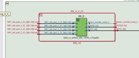

- The set_input/output_delay should be targeting the virtual clocks and the ports connected to DIE1_dib_pad_2_22*
- <<my understanding that the input from the EMIB inserted to the Die1 via DIE1_dib_pad_2_22_2[18] , dib_0 module does nothing in bypass mode (just routing) , and the OUT[18] is the continuation of the wire .>> Is this specific to your design? If not, then you may apply the timing constraints as suggested above.

- This is not specific from my implementation this is Module I get when I generated the DIB module .
