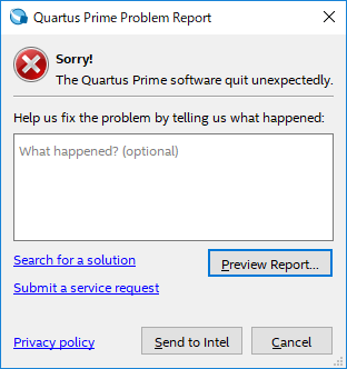

"Sorry! The Quartus Prime software quit unexpectedly."
When I enabled the Input Termination "OCT 100 OHMS" to an SLVS differential input, Quartus error windows pops up during Assembler stage. Synthesis and Fitting are successful. Does anyone encountered this problem? Below are the assignment of the SLVS pins.

And below is the preview report of the error message.
Problem Details
Error:
Internal Error: Sub-system: ASMIO, File: /quartus/comp/asmio/asmio_oct.cpp, Line: 922
Invalid obuf impedance matching enum: OCT_100_OHMS

Hi Everyone,
The problem was solved by changing to an allowed termination setting. I changed from INPUT_TERMINATION "OCT 100 OHMS" to INPUT_TERMINATION DIFFERENTIAL.
It successfully enabled the 100 ohms input termination on the differential input pins and the SLVS interface works.
