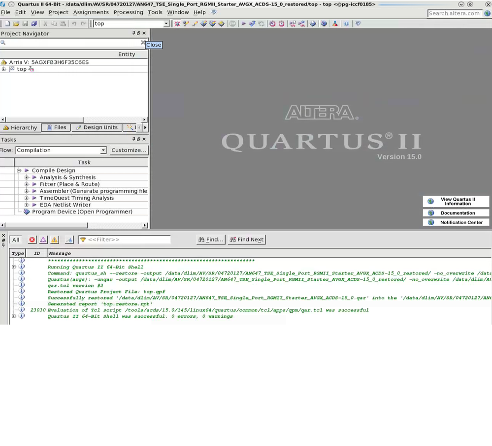

    May I know do you faced problem in downloading the AN647 AV reference design or facing issue in opening the reference design in Quartus.
    • If you see some error, may I know what's the error message ?
    So far, I can download and open it successfully as below
    dlim

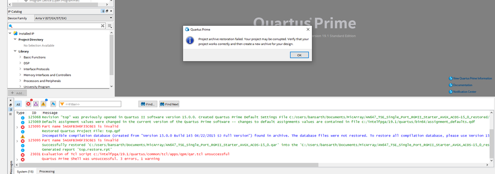

    • bansarth's avatar
      bansarth
      this is the error I get whenever I try to restore the project.
      • Deshi_Intel's avatar
        Deshi_Intel
        From your error message screenshot, looks like it's complaining you didn't open the project using Quartus v15.0. I can't see the full error message but you can re-read it at your side again to confirm.
        • Can you try open the reference design using Quartus v15.0 ?
        • Also make sure you have installed all the Arria V device database files that comes with Quartus installation.
