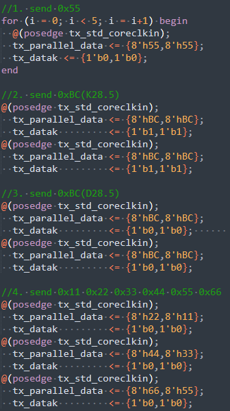

I tried inputting some data from tx_parallel_data (as shown in Figure 1), but tx_serial_data failed to correctly output these data. From the figure(as shown in Figure 2), you can see:
Figure1
Figure 2
  1. 0x55 & datak=0 -> (D21.2) ok
  2. 0xBC & datak=1 -> (K28.5) tx_serial_data unknown
  3. 0xBC & datak=0 -> (D28.5) ok
  4. 0x11 & datak=0 -> (D17.0) tx_serial_data partial unknown
  5. 0x22 & datak=0 -> (D2.1) tx_serial_data partial unknown
  6. 0x33 & datak=0 -> (D19.1) ok
  7. 0x44 & datak=0 -> (D4.2) tx_serial_data partial unknown
  8. 0x55 & datak=0 -> (D21.1) ok
  9. 0x66 & datak=0 -> (D6.3) tx_serial_data partial unknown
Why does tx_serial_data show as unknown?

      Thank you for your response. I later found out that I need to transmit information from tx_parallel_data before the tx_serial_data automatically stops sending data to avoid unknown events.
      For example, after deasserting tx_digitalreset, I need to continuously send synchronization signals /K28.5/ for a period before starting to send my data, instead of waiting for a while after deasserting tx_digitalreset before sending my data. Is this process correct?
