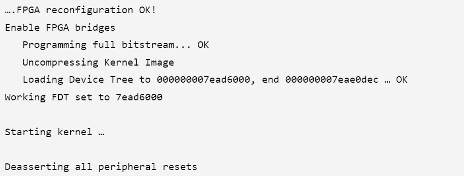

Okay, so using the GHRD from Rocketboards, the FPGA configuration is done right before "starting the kernel", including enabling the FPGA bridges:
Is it possible that you check again the signals behavior after booting to Linux as root in the signal tap? That would confirm that the bridge and FPGA enable and configured and the signal should behave as it should.
If you still see otherwise, let us know.

I use
U-Boot SPL 2023.07-rc6 (Nov 20 2023 - 08:40:20 +0000) - got from GSRD
andU-Boot 2023.10-31805-g69d5338be0-dirty - built by myself according to rocketboards guide
and boot log looks like this:
