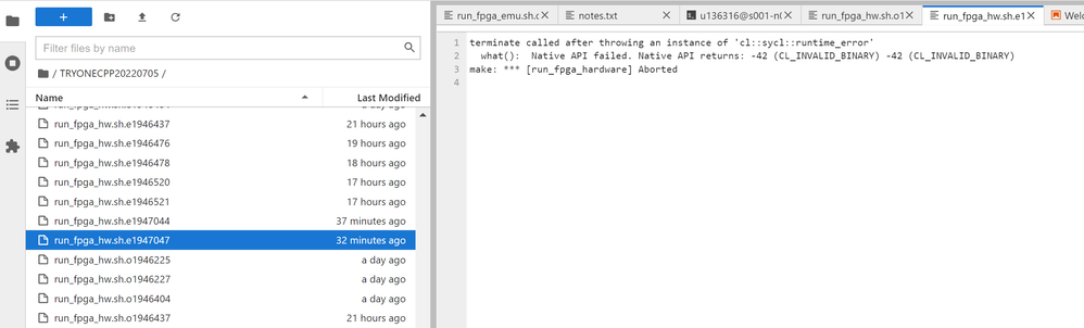

for arria10 error :
terminate called after throwing an instance of 'cl::sycl::runtime_error'
what(): Native API failed. Native API returns: -42 (CL_INVALID_BINARY) -42 (CL_INVALID_BINARY)
make: *** [run_fpga_hardware] Aborted

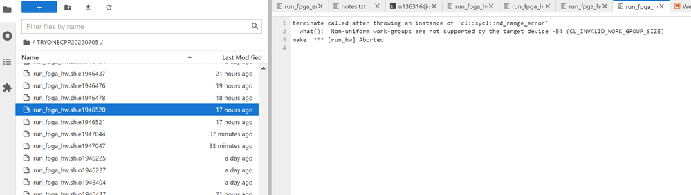

for stratix10 error:
terminate called after throwing an instance of 'cl::sycl::nd_range_error'
what(): Non-uniform work-groups are not supported by the target device -54 (CL_INVALID_WORK_GROUP_SIZE)
make: *** [run_hw] Aborted

  • Wei-Chih's avatar
    Wei-Chih
    Hi Aik
    I think it's not code running problem cause I can use Arria10 normally. Below is error message.
