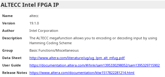

    Based on ALTECC Intel FPGA IP description,
    The ALTECC megafunction allows you to encoding or decoding input by using Hamming Coding Scheme. Check image:
    Hamming code implementation at source device should be not a problem.
    Document link: https://www.intel.com/content/www/us/en/docs/programmable/683490/20-3/altecc-encoder-features.html
