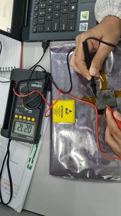

Hi Intel Team, I would like to send one defective FPGA to your side for failure analysis. Reject details as below:
Issue: 1pc PCA failed at customer side. After further inspection, and removed AE1822-5776LF, found out the FPGA component measured as short from H20 – GND.
PN: AE1822-5776LF
MPN: 5SGSMD8K2F40I2LG
DC: 2031
PO: 4514972836
Qty: 1pc
H20 - GND resistance measurement
