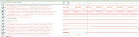

6 years agoremoval VCXO, Avalon-MM addresses
Hi, I try to remove VCXO module from my project and to use re-clock module as described here: https://www.intel.com/content/dam/www/programmable/us/en/pdfs/literature/an/an746.pdf As ...
JonWay_altera
6 years agoHi,
Could you please confirm if the reference clock of the
TX PLL is correct? As per the user guide, it is required to running @ 100MHZ
from oscillator.
Besides, you can refer to the following document to
generate the example example without VCXO from the IP GUI by using the newer
version of Quartus and see if encounter the same problem.
https://www.intel.com/content/dam/www/programmable/us/en/pdfs/literature/ug/ug-sdi-ii-de.pdf
