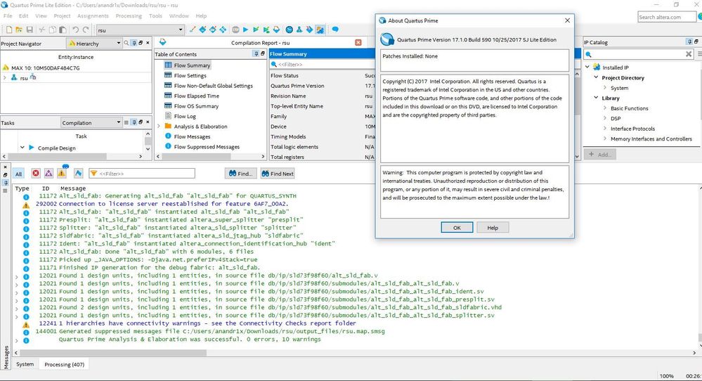

  • AnandRaj_S_Intel's avatar
    AnandRaj_S_Intel
    1. Delete db, incremental_db folder & the unknown folder created by qsys system in you project.(make sure you have closed the quartus.)
    2. Now you can open project with Quartus also open Qsys with unknown.qsys file and save the qsys system has rsu.qsys and generate it.
    3. Import rsu.qip file and compile
    Anand Raj Shankar
