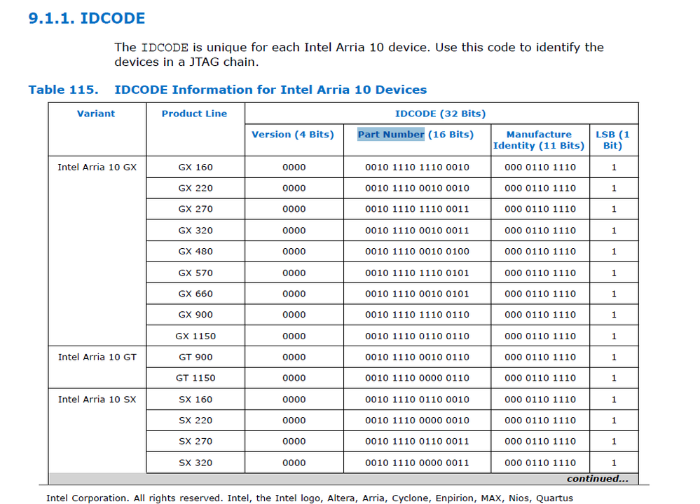

- ddroe
Hi Aiman,
according to your docs, the top side marking shows the part number, and in the following table the part number is defined as follows:
The above table defines what can be retrieved through JTAG. If you know any way to get the more detailed device model number, I'd be happy to learn about it.
David
