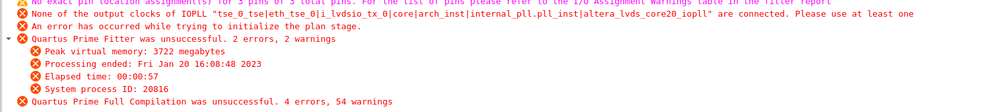

Quartus prime pro 20.3 Fitter Error
I am trying to compile my design with TSE MAC. I could see a fitter error from quartus which seems to be from internal PLL in one of the IP. Can you kindly help?
Note that the same design is working fine with 17.1 prime.
Hi MK_ABQ,
It's seem look like the problem of clock pin. You are required to use dedicated clock pin if you want use clock pin. Below .qar file compilation successfully from my side.
Zi Ying

Hi MK_ABQ,
Zi Ying
- MK_ABQ
Contributor
Hi Zi Ying,
Please find the project attached hereby. And sorry about the typo in the title. Fitter error found in 18.1 version.
Error found in Quartus 18.1.0 Build 222 Pro edition.
