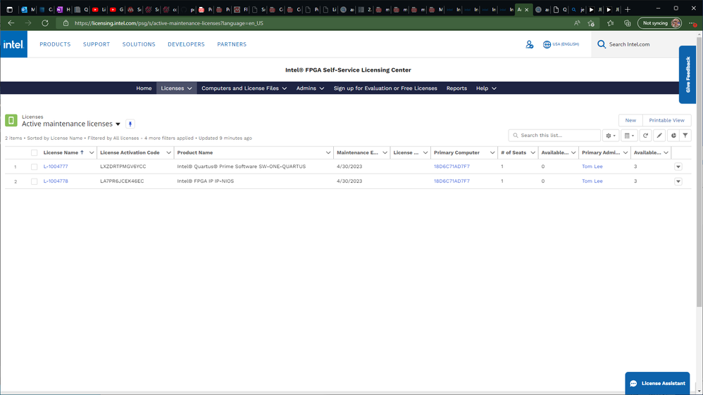

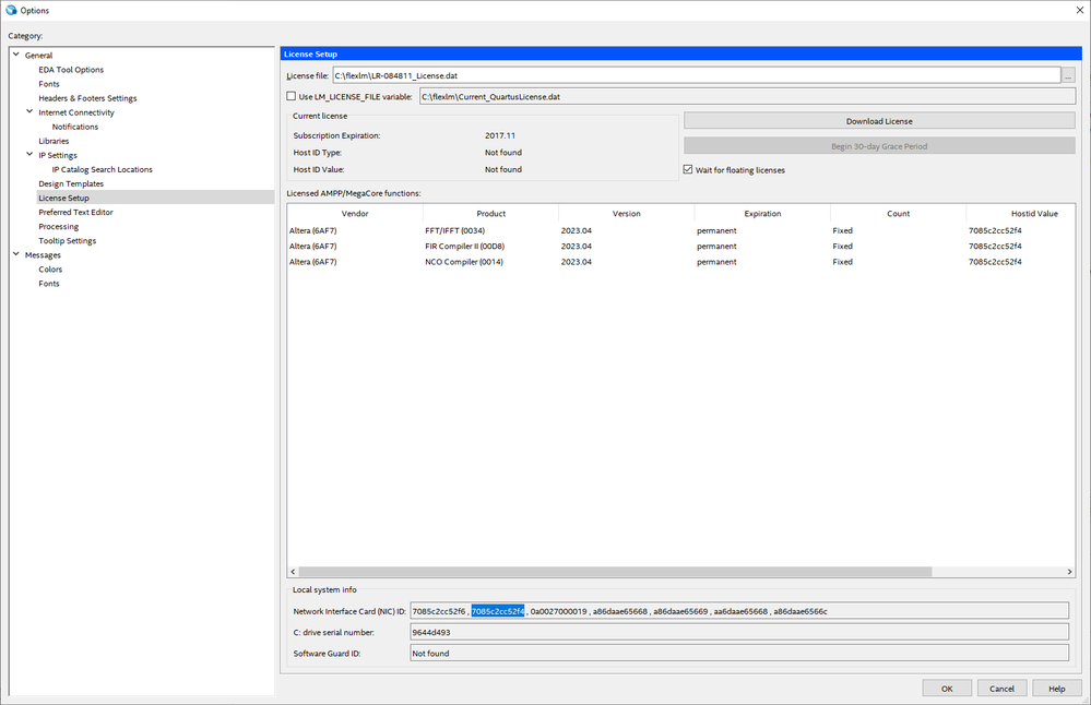

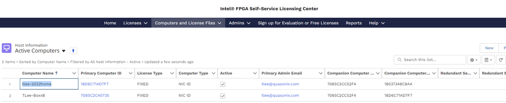

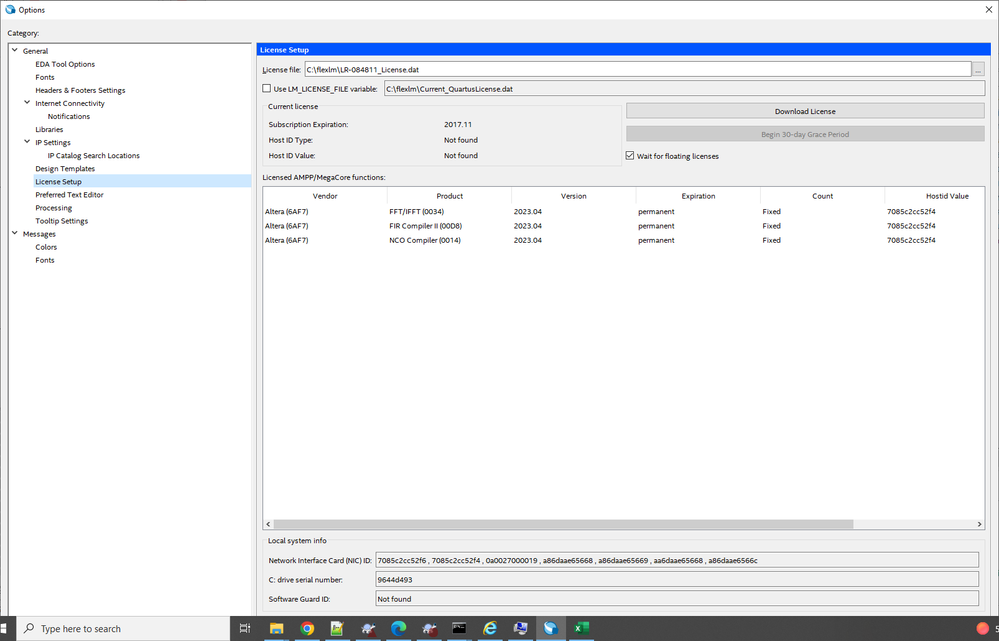

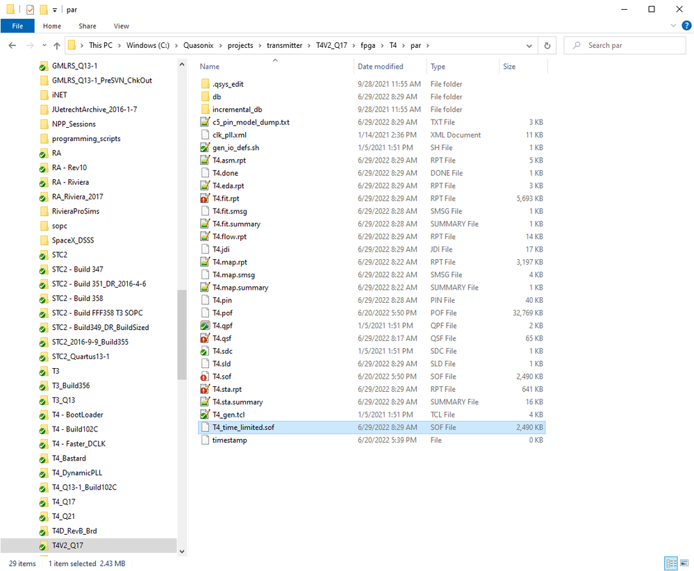

The new Quartus license is not recognized by Quartus. Attached is the .dat file which was generated. The computer: tlee-2022home is my current active computer
When using the Quartus license setup tool to read in the license file, while the NIC ID in the license file and the computer NIC ID match, Quartus does not recognize the licensed function so running a Quartus build results in a time-limited .sof.
I have tried generating another license file but no change/improvement. Need support to resolve the issue.

      The Nios II license was purchased at the same time as the Quartus license:
      When I generated the license I had both licenses selected. Is there another way to get both licenses in the one generated license file?

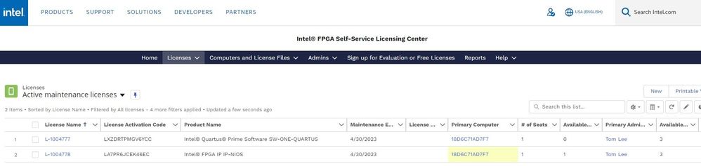

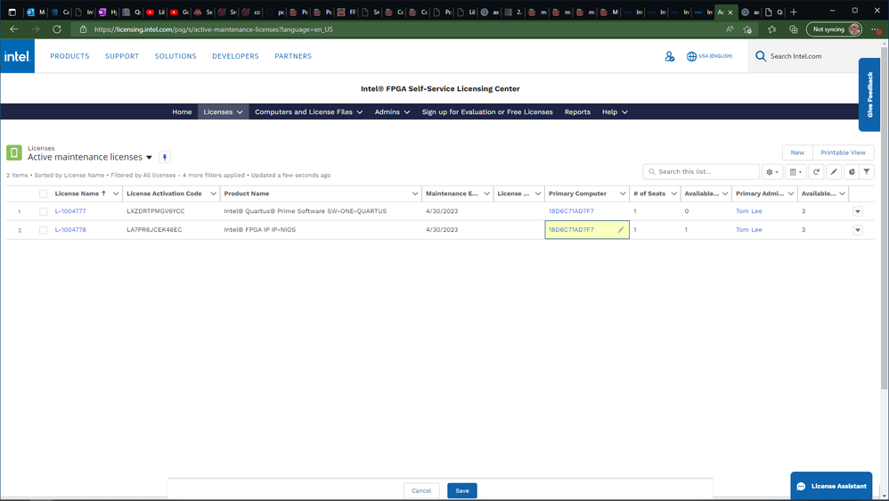

        I solved the issue. In the active maintenance license page, even though the Nios license showed the correct primary computer, it was not being generated. I edited the license the Nios license settings primary computer setting to none, then back to my active computer; saved and generated a new license file. Now Quartus generates a .sof that is not time limited.

    3) Error message screenshot: No error message, Quartus license setup tool read in of license file does not show license for Quartus and build will only generate a time_limited.sof
    4) assembler report .asm.rpt file: see attached T4.asm.rpt.txt file.
