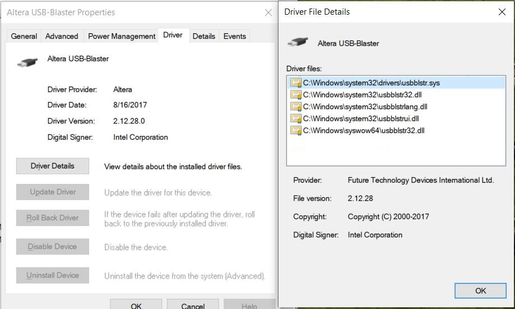

    I expected info like below under driver details:
    I wonder what "Remote Local Server" is. I don't have it under Windows 10.

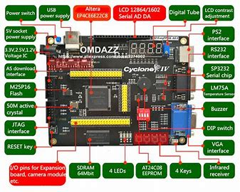

      Hi, it's a EP4CE6E22C8N board, it looks like this:
      I'm not sure if what I said about "embedded JTAG" is correct, I'm sorry, I'm new to this. But, it comes with a USB Blaster cable to connect to the computer.

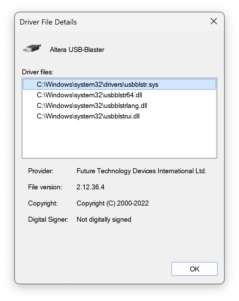

      About the driver:
      I should also add that the USB Blaster and the board itself works fine, as I've already tested it on another computer.
