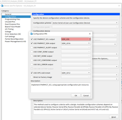

compared the project and found change is qsf for the pins
"set_global_assignment -name USE_PWRMGT_SCL SDM_IO0
set_global_assignment -name USE_PWRMGT_SDA SDM_IO16
set_global_assignment -name USE_HPS_COLD_RESET SDM_IO12"
Assignments ➤ Device ➤ Device and Pin Options ➤
Configuration Pin Options.
tried to change pins according to tool is not accepting the change(please see the attached snapshot)
other than this there is no change!

As tool is not accepting the change, tool is upgraded to 21.1
