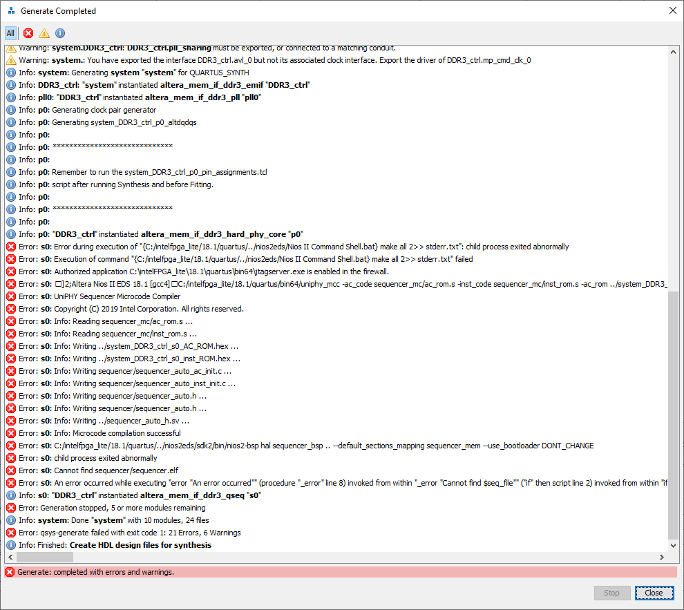

For a project with a DDR3 SDRAM Controller, I am using Quartus 18.1 Lite with Platform Designer on a Windows 10 PC.
After installing WSL (Windows Subsystem for Linux), an error occurs when I try to generate code in Platform Designer., even trough Quartus 18.1 should not depend on WSL.
The immediate error is "Cannot find sequencer/sequencer.elf", where it appears that a Makefile fails to generate the file sequencer.elf.

So it appears, that somehow enable of WSL causes execution of the bash script "c:/intelFPGA_lite/18.1/nios2eds/sdk2/bin/nios2-bsp" to fail when it is called from the temporary Makefile.
The error and some script arguments are shown in the picture below.
Error in PD when building DDR3 Ctrl. code after installation of WSL
If I disable WSL in Windows 10, then generation of code in Platform Designer works again.

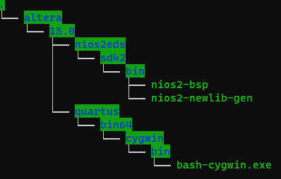

So anyone reading this thread, here is my workaround for the same issue that I have in quartus web 15.0
Here are some files that needed to be modified/created:
bash-cygwin.exe is a copy of bash.exe
nios2-bsp and nios2-newlib-gen have a modifed shebang which looks like this:
#!/bin/bash-cygwin
The fix is basically making sure, that the wsl bash is not called anymore.

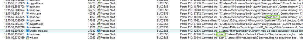

Here is a look from process monitor, about the root cause: Normally the bash.exe from cygwin is called, but the shebang in the file somehow ends up calling the wsl bash.exe
Cheers for all the folks out there who need to use an older quartus but also want to have wsl installed.
