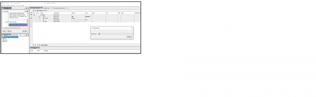

Hi guys,
I am very new to using Qsys at this time. I have bought the Cyclone V SoC Development Kit recently. And I have found that Qsys hangs as I was trying to add the Cyclone V Hard Processor System.
I have attached a snapshot here as well.
Can I ask you if something is missing on my system ?? am I missing a license or something ?? Or at least, what can I do to find out the root cause and how to fix or work-around this issue ??
TH

    I have just found out that Qsys also hangs when I was trying to open a system (i.e. soc_system.qsys) as well.
