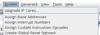

(Platform Designer, not Qsys FYI)
The Assign Base Addresses option will set the base address for any unlocked agent interface. You can click the little lock icon to prevent this command from potentially changing the address if you have manually set the base address yourself. The end address is automatically set based on the design of the component and the base address set. You can't edit the end address.
