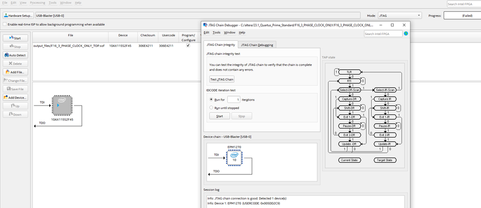

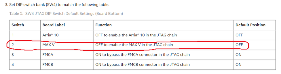

I've put development board switch SW4-2 in the ON position to disable the MAX V in the JTAG chain as described in the kit user guide:
However, the programmer still fails to configure the Arria 10:
Error (209015): Can't configure device. Expected JTAG ID code 0x02E660DD for device 1, but found JTAG ID code 0x020A30DD. Make sure the location of the target device on the circuit board matches the device's location in the device chain in the Chain Description File (.cdf).
And the MAX V still shows up in the JTAG chain:
Any ideas? Thanks.

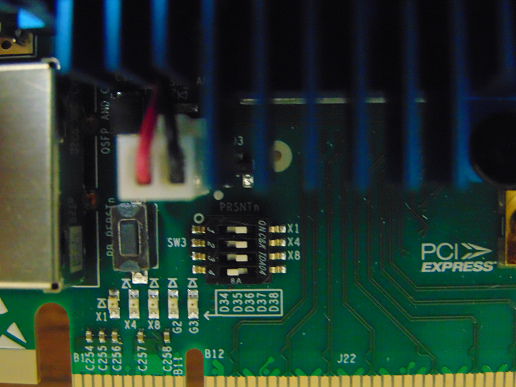

2 years agoHi Aiman,
Here are the board's SW3-SW6 switch positions. SW4-2 is in the ON position yet the MAX V device is still in the JTAG chain. Can you provide any further assistance? Thanks.
