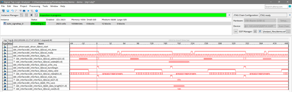

problem using altmemphy to read ddr2
Device: EP4CE22F17C8
Memeory: Micron MT47H64M8CB-3
IP: altmemphy DDR2
Burst count = 16
I met a problem to read out data using altmemphy.
1) if I start with write operation ddr2 at first, after finished; then try to read data out of memory, then I can never get the data, the local_rdata_valid is always low.
2) if I don't do any write operation, try to read the data out of memory, I can get it successfully.
I don't see any problem with my write process.
What's wrong?
Picture : write + read

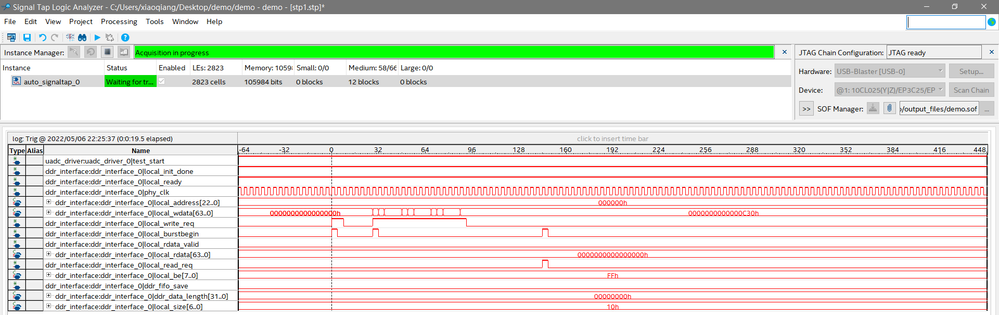

Picture only read
