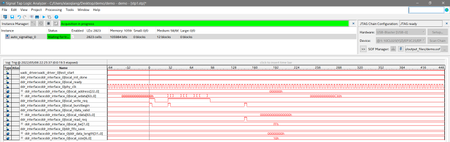

Device: EP4CE22F17C8
Memeory: Micron MT47H64M8CB-3
IP: altmemphy DDR2
Burst count = 16
I met a problem to read out data using altmemphy.
1) if I start with write operation ddr2 at first, a...

4 years agoHello,
Did the calibration finished properly in the design?
What is the test_start signal does?
Is there a waitrequest signal in your design?
How do you perform the write and read transaction?
