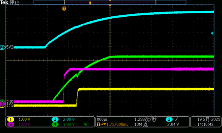

Hello Experts,
I am using the LDO for Cyclone 10LP power supply, but the none-monotonous power rise is found during the power up on my board as below figure shown. This may be caused by high inrush...

I found a forum posts related to the topic.
Non-monotonic rise on the power supply - Intel Community
The datasheet has the following statement "All supplies must be strictly monotonic without plateaus." This is specifically applicable to all VCC voltages.
Please check the recommendations at the footnote below Table 3 of the datasheet.
