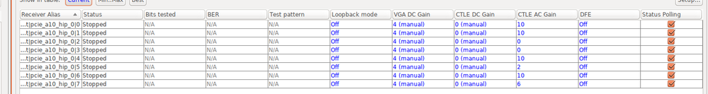

  • SSilu's avatar
    SSilu
    I'v managed to run toolkit with minimal project. However it seems reconfiguration interface for rx is not active - it means I cant set prbs pattern or loopback. Also both tx and rx report wrong link speed 5G - I expect 8G for PCIe gen 3 hip. Is running ADME with PCIe HIP supported at all?
