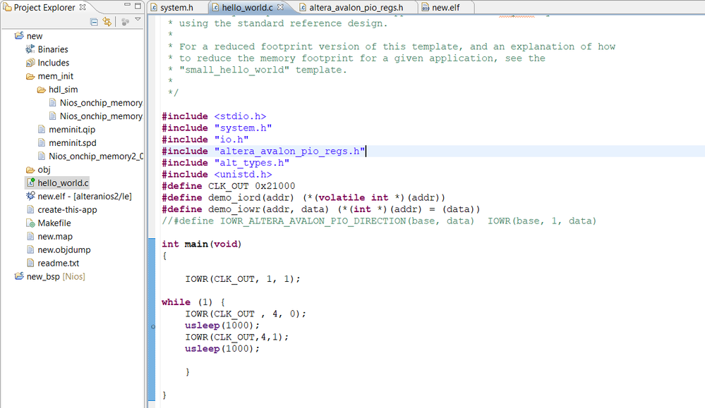

Hello, I'm using the DE0 board from altera and I wrote a little program to toggle an output pin from high level to low level and vice versa. That's my program :
I'm not sure if he contains all the lines necessary to make my project work but, if it's the case, how can I convert my C program (I think that's the .elf) into an .sof for hardware application ?

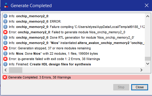

    Make sure you're doing the steps correctly as stated in this video https://www.youtube.com/watch?v=joFaxLY-rUE. Based on Generate Completed window line 3, can you check the reason for causing that Failure compiling 'C:/Users/elyes/AppData...'. Alternatively, you can specify the HEX file with QIP.

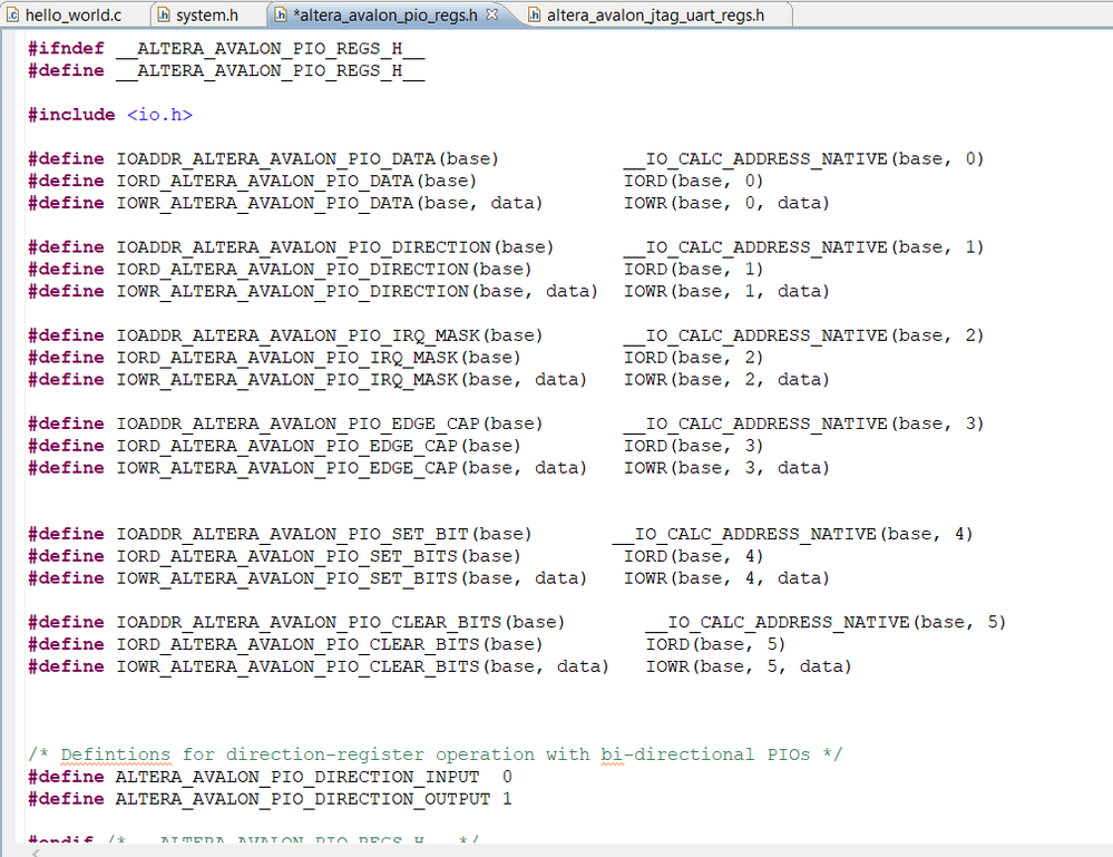

    and here the command for setting bits ;

    I tried to put my memory init in the on_chip_memory peripherals on Qsys to make a .sof file
    but it don't want to generate
