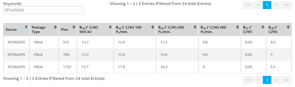

Need updated Thermal Characteristics for package changes introduced by PDN1926
For following Arria2GX package change:
Looking for updated thermal figures for 780 pin package or confirmation that they are unchanged.
Thank you

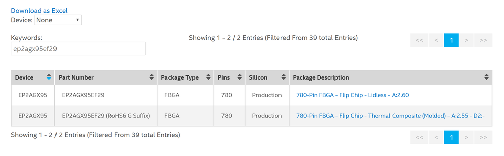

  • SLabe's avatar
    SLabe
    @RahulS_Intel​ , is this case being worked on by the Factory?
    Also, can you confirm the country of origin is the same for the G suffix?
    Thank you for the support!
