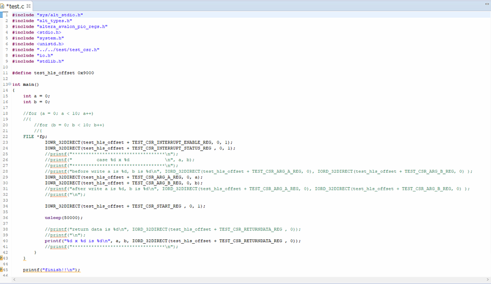

Now, I want to change the system to read the two numbers to be multiplied from a file and output the calculation results to another file.
We think it will mainly be a rewrite of test.c.
I know that I need to write FILE*fp; etc., but I would like to know in detail how to pass the numbers from the file to a and b, and how to output the calculation results to a file.

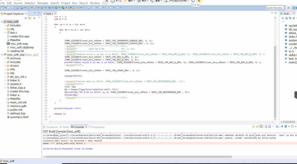

    Now that I have a better understanding of how to input files, I tried only outputting files and got this error.
    • gazel's avatar
      gazel
      It seems that the on-chip memory is not large enough.
